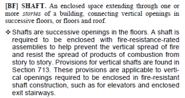

I'd say yes, but I do not know what a "vertical service space" is....
In Canuckian terms - it's a fire-rated assembly that runs vertically through horizontal fire separations; building services run through the vertical service space must (usually) be fire-stopped at the low penetration point unless it's something like a pipe through a ground-floor slab, and also at the upper penetration point.
so a "shaft"?
So it's what we in the colonies call a "shaft"?
Just this colony. Not sure about the others. Looks similar. Here is our definition.
Vertical service space means a shaft oriented essentially vertically that is provided in
a building to facilitate the installation of building services including mechanical,
electrical and plumbing installations and facilities such as elevators, refuse chutes
and linen chutes.
