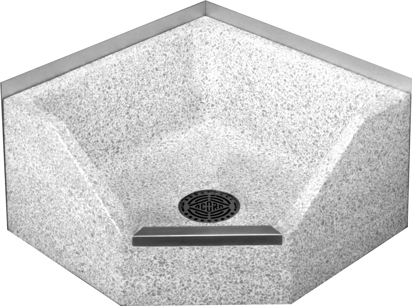

Is a floor mounted mop sink treated just like a floor drain? Is there really a difference? Trap primer issues?
A mop sink has a faucet so I would not be inclined to require a trap primer.

" Is a floor mounted mop sink treated just like a floor drain? Is there really a difference? Trap primer issues? "
IMO, ...Yes, there is a difference !........The difference is frequency of use
and re-supplying water to the Fixture Trap Seal through normal [ frequent
use ] and not thru using a Trap Primer.

So the difference between a floor drain and a mop sink....well for one, with a floor drain the floor needs to slope towards a floor drain. A conscientious inspector will tell the contractor that before they place the concrete.....in writing,,,for use later.
No mystery really!........The T & P Relief Valve, Drain Line
can be directed to and terminated at an approved Floor Drain,
...Floor Sink, or Mop Sink......Same with any overflow drain
lines, ...do not create any type of [ possible ] tripping hazard
on the floors.
