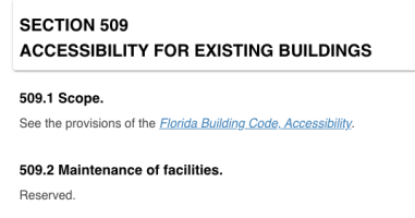

Florida takes the ANSI A117.7 and makes it their own by removing Chapter 11 from the IBC and placing scoping in the beginning of their edited version of the ANSI, calling it the FBC Accessibility. Most of it is verbatim with some changes. Here is 101.2 of the FBC Accessibility with some verbiage you may not see in the ANSI A117.1.
101.2 Effect of Removal of Barriers in Existing Facilities
Removal of architectural barriers, pursuant to 28 C.F.R. s. 36.304, from buildings, structures or facilities shall comply with this code’s requirements for alterations unless compliance would render the removal not readily achievable. In no instance shall the removal of an architectural barrier create a significant risk to the health or safety of an individual with a disability or others.
This code applies to alterations to existing facilities that are subject to the barrier removal requirement under Title III of the ADA to the extent required by regulations issued by the Department of Justice incorporated in 202.6.1 and to alterations undertaken by Title II entities to provide program access.
This document does not address existing facilities unless altered at the discretion of a covered entity. The Department of Justice has authority over existing facilities that are subject to the requirement for removal of barriers under Title III of the ADA. Any determination that this document applies to existing facilities subject to the barrier removal requirement is solely within the discretion of the Department of Justice and is effective only to the extent required by regulations issued by the Department of Justice.

To me, this is the key phrase: " The Department of Justice has authority over existing facilities that are subject to the requirement for removal of barriers under Title III of the ADA. Any determination that this document applies to existing facilities subject to the barrier removal requirement is solely within the discretion of the Department of Justice and is effective only to the extent required by regulations issued by the Department of Justice." To me according to the 101.2, the DOJ is the only one with the authority for alterations that are covered by the ADA. The enforcement is not the Florida building code for barrier removal or alterations to be made accessible. ADA caps the cost at 20% going directly to path of travel and all elements attached to the route going to the altered location, including parking.
The federal Department of Justice enforces the ADA (and apparently a few states have formally adopted the ADA as their accessibility standard, so there may be overlap in those states). In most states, accessibility is required under chapter 11 of the IBC and the technical standards are found in ICC/ANSI A117.1. For those states that have not deleted IBC chapter 11 when they adopted the IBC, accessibility under the building code operates entirely independently from the ADA.
Under the ICC codes, the 20% rule is found in IEBC 306.7.1, Exception #1. Again, for those states that have adopted the IEBC, this operates entirely independently from the ADA, but the ADA still applies and is enforced by the federal DOJ. This actually creates double jeopardy, because making the same mistake under the ICC codes and under the ADA legally constitutes two violations.
For states that have adopted the ADA instead of chapter 11 of the IEBC and ICC/ANSI A117.1, I would read the adopting language VERY carefully before deciding that only the [federal] DOJ has jurisdiction/oversight.
