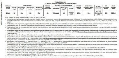

I am trying to size a footing for a 7' ceiling height basement that will have a slab and 6' concrete poured walls (measured from top of footing to top of concrete) retaining 5' of dirt. supporting 1 wood frame story on top.
this is in Seattle, here is our SRC:
http://www.seattle.gov/dpd/cs/groups/pan/@pan/documents/web_informational/p2631466.pdf
TABLE R403.1(1) is for light frame construction walls.
TABLE R403.1(3) is for cast concrete walls.
the stem walls are obviously going to be concrete, but then on top of that is my light frame construction... so which material are my "walls" and thus which table do I us?
I am also trying to determine what the "snow load" is for my area. Any idea where I can find this?

For snow load look in the beginning of Chapter 3, if the map is not clear, ask the local Code Official.
Dylan, the (ground) snow load is 25 psf. Use Table R403.1(1) for light frame construction with basement.
Typically the soil is default at 1500 psf unless known or provided from the Building Official.

This is great information, and I recognize the snow load stuff in CH3 now, so I must have found it previously at some point and forgotten.
So if I use light frame (makes sense) and I assume 1500 for ground, 1 story plus basement, and 25 psi snow load I arrive between 18 " wide for 20 psi snow, and 19" wide for 30 psi snow. So my footing should be 18 1/2" wide. Does the fact my concrete wall will be 8" thick affect this sizing? (Due to more than 4 ft retained and seismic area D, it needs to be 8").I could in theory reduce the width a bit since the biggest distance from my existing structure is 12 ft. the chart says 32 ft with wall in middle, so this would be 16ft in my situation, that extra 4 ft would allow me to knock 4" off my width if I wanted, correct?
