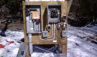

Forgot One Thing: Temp Service for Construction Site
Be honest with you, I haven't seen very many conduit expansion sleeves installed on a temp set-up, you might be the only one doin that?
The weatherproof covers get tore off in about the second month of construction.
Communication grounding block, now that's a new one.
Required by POCO for UG temp services
