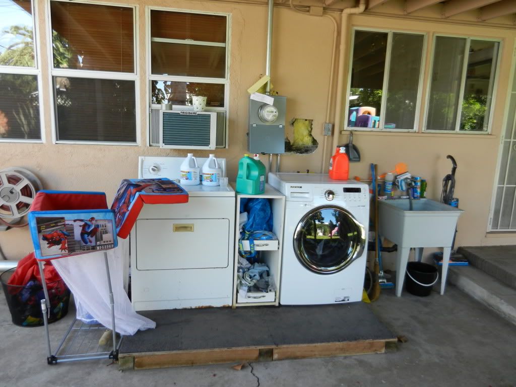

The electrical contractor called me this morning. He gave me a five minute rundown on what he did from the weather-head to the ground rods. He said he prides himself on passing at the first go round. I'm guessing that this was his first service upgrade. He received another six corrections besides the working space.
I would have thought the spiderman clothes hamper would have gain a few bonus points. I am curious how others feel about moveable appliances encroaching into the work space.

I am curious how others feel about movable appliances encroaching into the work space.
Me too. Would it make a difference if the platform were on wheels?
ICE, Are those correction notices attached to the meter socket or fabric sheets?
Hun, Is that my good shirt in the backyard?
pc1
It must be fun to go out into the heat, stuff a bunch of clothes in the dryer, and be blasted in the face with all the hot air eminating from the window AC.
steveray said:
Working space for the service or the switch above the front load washer? :)
There ya go. It's a disconnect for something and as we all know, every disconnect requires working space. Or is that only for condensers? :devil
