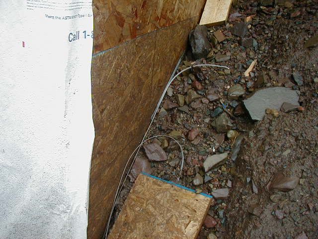

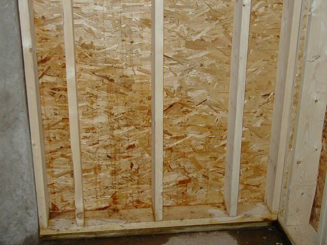

I was hired privately due to problems with this house.
It was suppose to be poured concrete but instead they framed it and I saw this:
After I saw this, I could not figure out what would be causing that wet mark on the OSB.
Turns out it was BACKFILL and NO, I am NOT KIDDING
