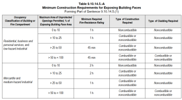

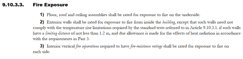

The tests referred to in 9.10.3.1 are regarding FRR, not temp. rise limitations.
Is it trying to say that if the building has a LD of more than 1.2m there is no FRR required for the exterior walls? If so, this would contradict 9.10.14.5, which shows a minimum 45min FRR for all exterior walls:
When I go to 3.1.7.2 for clarification, I get more confused.
(2) is strictly referring to requirements for temperature rise limits on the assembly. It does not modify the requirements for the hourly rating.
There are requirements related to temperature rise in ULC-S101 for the assembly to achieve an hourly rating. This is just indicating that the temperature rise doesn't have to be a restraining factor if other measures are taken to deal with temperature rise. There would be no impact on assemblies under the Part 9 tables or Appendix D.
Temperature rise limitations are to prevent walls from getting hot enough in a fire to set nearby combustibles on fire. Some assemblies might reach this temperature before they fail structurally. If so, these assemblies should have 2 ratings - one for temperature and one for structural failure.
As I thought, thanks.
Thanks for the clarification

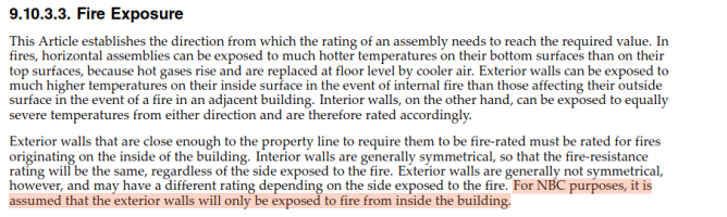

Looked at the BCBC part 9 assemblies. EWx (Exterior wall assemblies) in BCBC is same as NBC - f/r drywall on the interior only. This is consistent with 9.10.3.3(2) which states that exterior walls need only be rated for exposure to the interior.
The Part 9 illustrated guide kinda explains this better than Code.
