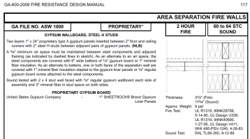

Ok, what is your take on the following section of the fire resistance design manual?
I have a plan wherein they want to run water supply lines through the fire wall (req'd due to building size) and utilize fire caulking. Typical supply lines are PEX, but will have a section (24-in) of copper pipe penetrating the fire wall with the annular space sealed with fire caulking.
My challenge to the design team, is that although through penetrations are permitted by IBC 706.9 / 714, the GA Manual, which is the listing they are proposing, does not permit "Openings and through penetrations, including protected openings and penetrations". (see highlighted text in image) The listing is more specific than the IBC, so it should prevail in my opinion.

I am wondering if that is a just a general comment???
Openings and through penetrations, including protected openings and penetrations, are not permitted in the area separation fire walls contained in this manual
You cannot even have a door in it?????????????
I am thinking fall back to what IBC says
Call out UL Design U336 or V411 instead, which are the assemblies that GA's assembly is based on (see "Fire Test" information in the lower right corner of the GA assembly). UL doesn't have a similar limitation.

I don't know where party walls were mentioned, but the only difference between a fire wall and a party wall is the permitted use of openings--and even that has changed in the 2018 IBC.
