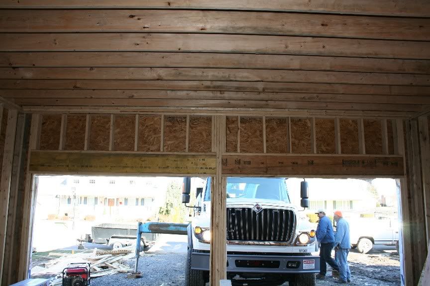

Garage Portal Framing
13,315
Would not listen to plan review comments.
This was taken right before they tore it out and reframed it.
Stupid is as stupid does. We always hand out the APA on Portal Framing to the new builders. A lot of them state that they have never heard of that! DUH!!!!
