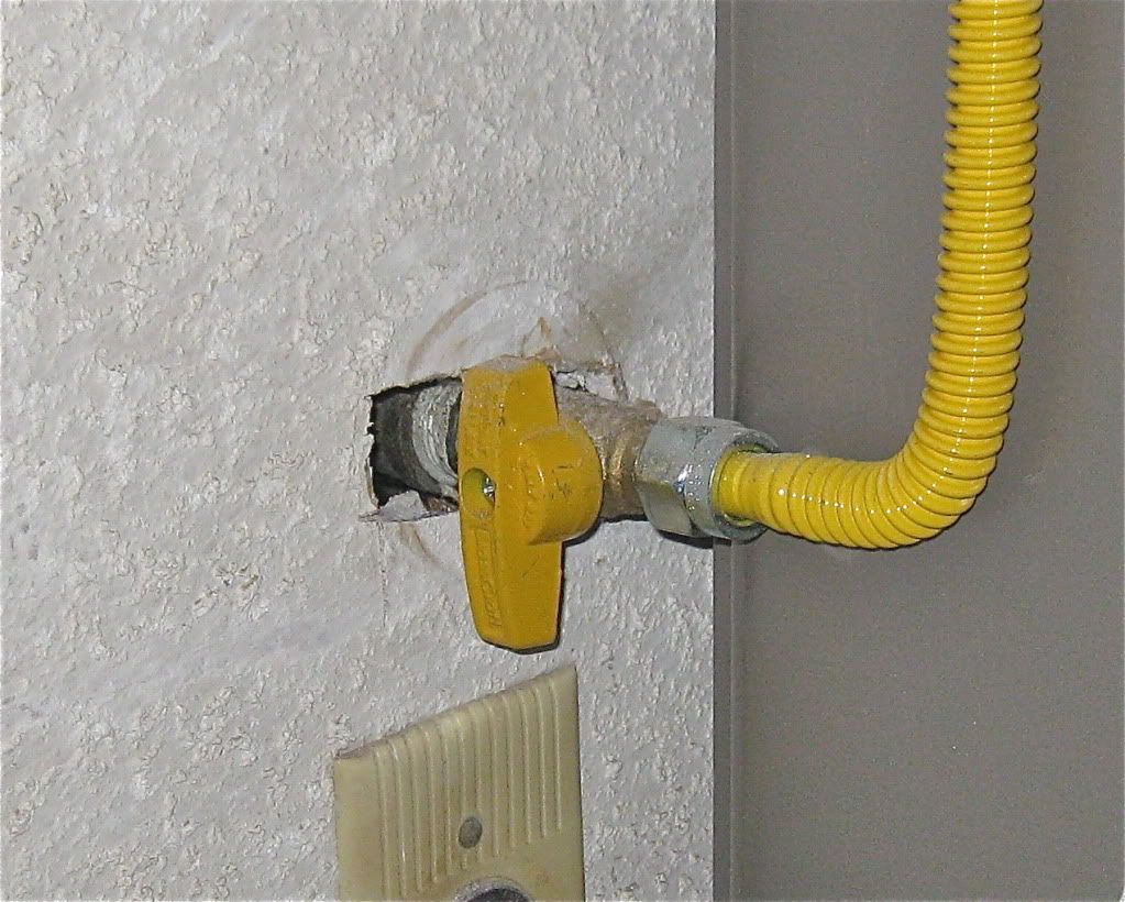

This is a clothes dryer location in a house that's not occupied and is undergoing a rehab by a flipper. Would you require that the gas cock be capped? Is there a code for that?
Any thoughts on the choice of dryer vent. It runs ten feet between two floor joist and daylights through the rim.

So I was nosing around 1211 when I found this:
The unthreaded portion of gas piping outlets shall extend not less than one (1) inch (25 mm) through finished ceilings or indoor or outdoor walls. [NFPA 54:7.7.1.4] It looks like they missed that here. Me too.

Need to be able to turn the valve ???
Maybe it is to be able to hold the pipe as the valve is threaded onto the pipe. You can always remove as much wall as needed. :D
I don't do residential, but I like to see a 90°. Then the gas connector does not need to make the bend, and there is less worry about the appliance banging into the connector.
IFGC 406.6.2 Before turning gas on-------------- no open fittings or ends and that all valves at unused outlets are closed and plugged or caped.
What North Star says, and Length Limitations 504.3.2.2 CMC Unless otherwise permitted or required by the dryer manufacturer's
installation instructions and approved by the AHJ, domestic dryer ducts shall not exceed a total combined horizontal, and vertical
length of forteen (14) feet, including two (2) 90 degree elbows. Two (2) feet shall be deducted for each 90 degree elbow in
excess of two.

I don't approve corrugated vent. Do you?
This is not a plumbing code topic but in both mechanical and gas codes flexible (transitional) ducts are limited to 8 ft. in length and cannot be installed behind walls, below floors and above ceilings.
This is one of my pet peeves with the code terminology though gas dryers convey products of combustion they do not vent; the ducts are exhausted!

Francis Vineyard said:
This is not a plumbing code topic but in both mechanical and gas codes flexible (transitional) ducts are limited to 8 ft. in length and cannot be installed behind walls, below floors and above ceilings.This is one of my pet peeves with the code terminology though gas dryers convey products of combustion they do not vent; the ducts are exhausted!
Francis
If it is a electric dryer the exhaust is not products of combustion! Is it then considered a vent?
Msradell, thank you for making that point but the codes do not make this distinction; this is where a fuel burning appliance does not vent. I'll make a separate post about this in mechanical code.
