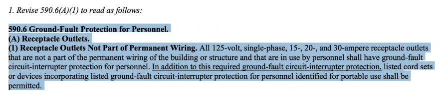

Construction Sites come to mind.
This is from a TIA concerning the 2014 NEC. Regardless of what your codebook says if you don't have a recent printing, here is the safety change:
