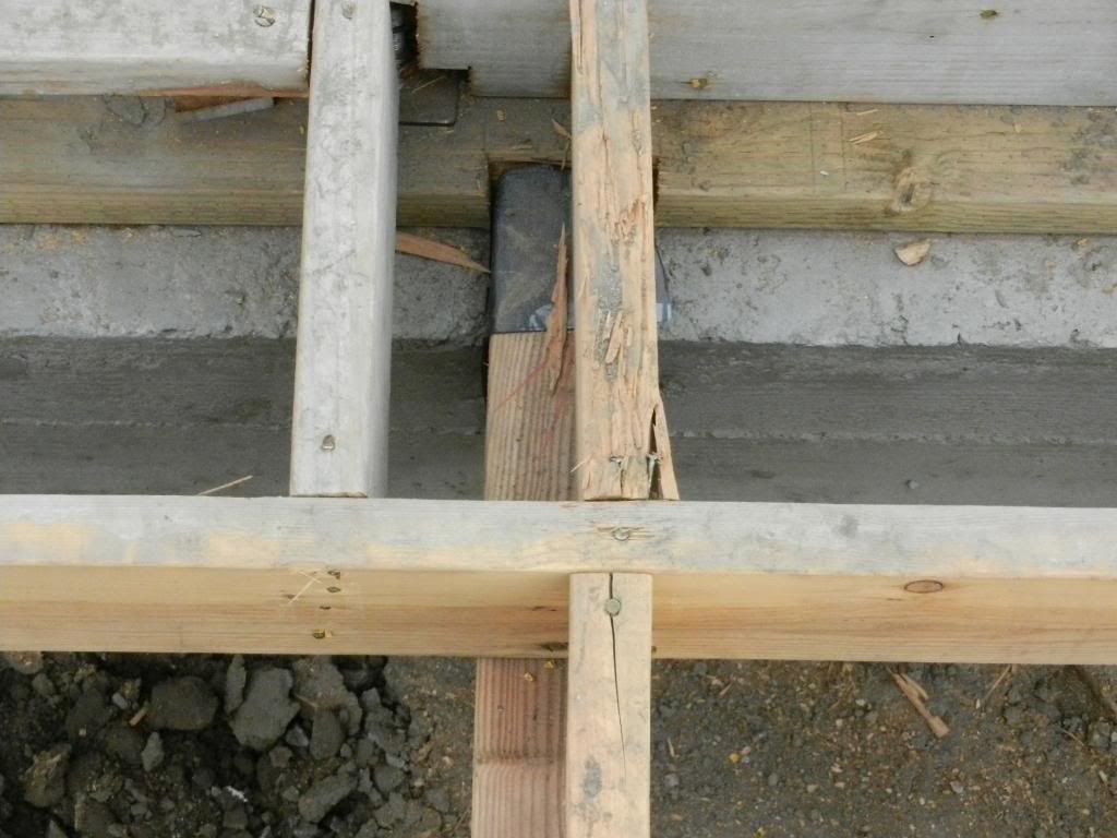

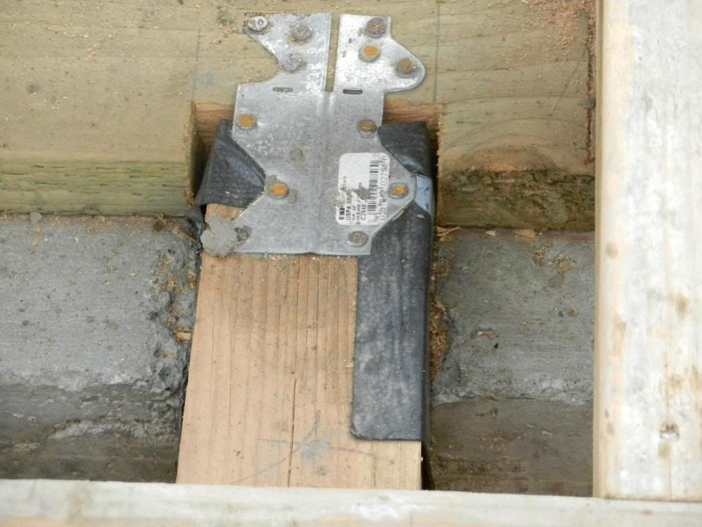

There is no gap. There is rubber. Do you make them fix it? eight times
Rider Rick said:
ICE,It will rot.
Someone will need to fix it later.
I'm not so sure about that. Here is an example that lasted 85 years.
I had pictures of decay free girders and posts that were embedded in concrete since way before you were born, but my computer died and those pictures are gone.

What about the rubber?
Does sixty mils of sticky rubber count for anything?

As long as the non-pt girder is not touching concrete at all, I'd say the 60 mil membrane is an approved alternate I this application and geographical location.
Time will tell.
I have dealt with the same exact condition as the photo in post #4 many times, both in an exterior foundation, and interior.
In all examples but one, there was minor rot on the ends of the full dimension 2 x 12 joists, but they had been there at least 90 years in the past. The one very bad example was in a very humid area of San Francisco near twin peaks, and those joists were encase in brick and morter and fully deteriorated. House was built in 1885 thereabouts.
My point is those joists in that climate probably have a good 100 years ahead of them despite a faulty installation.
