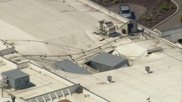

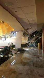

GluLam Failure
mark handler
Oct 25, 2009
11,678
So. CA
My latest RED TAG
Lucky Lady Casino in Gardena Monday morning after its roof partially collapsed, injuring nearly a dozen people.
https://losangeles.cbslocal.com/2019/07/15/casino-roof-collapses-in-gardena/
Any photos of the delam? Roofing was redone in the area, how long had it leaked and if so then why wasn't it observed earlier?
This will be a good "lessons learned case".
Going out there again today
Did not leak, no sign of water damage
