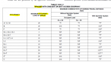

Let's say you have an unseparated building with (2) occuancies-- F-1 and B.
The exit access travel distance for a sprinklered building are the following.
  • F-1: 250ft
  • B: 300ft
Since this is an unseparated, would the more restrictive (250ft) apply for both occupancy areas?
whatever the answer, i would assume it would apply for common path of travel as well, correct?
