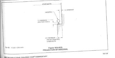

I cant find it but is there any code that will call out the maximum distance horizontally from the edge of the stair tread where the graspable handrail must be?

Is there an assumption that buildings built under IRC will always be of such low occupancy that a mid stair handrail is never required, regardless of width of stair? In fact, I think literally R311.7.8.2 prohibits mid-stair handrails, since they project far more than 4 1/2".

Only one handrail is required by the IRC. You can always install one on each side if you want to. You can install a mid-stair if your stairs are wider than 72 inches. Nothing prohibits you from exceeding the minimum code requirements.

Depends on which way you are measuring?
The text has been questioned if the intent is 4-1/2" each-way from each edge on each side Or just 4 1/2" inward.

If it's in the middle of the stair it is not projecting from the wall it's not attached to the wall it is a standalone rail. The language that I might be concerned with is in a residential setting the handrail must be on one side.

So if you who have a handrail mounted to a wall or guard, then a 4-1/2" projection seems simple to measure, but what if the handrail is mounted on top of posts which are attached to the floor and treads directly as it descends/ascends, and never returns or is attached to the adjacent outward structure?
As an inspector how do you determine the distance before the projection is not part of the equation?
