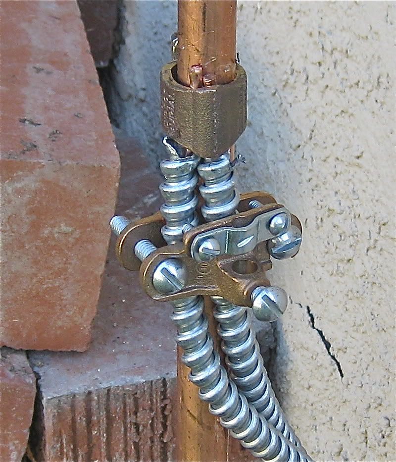

grnd rod clamp {PIC}
14,214
Would you say no?
Builder Bob said:
Not neccessarily..... Just curious as to why they are using MC for the grounding conductor?
That is an armored grounding electrode conductor. The armor protects the conductor from physical damage.
Builder Bob,
See Article 250.64 in the 2008 NEC, and E3510.2 in the 2006 IRC for this
protection requirement.
