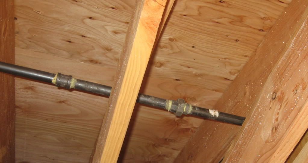

Ground joint union

For the new inspectors...... the union on the right is a ground joint union and is not permitted in a concealed location. Something else to watch for with gas pipe is Teflon tape. If it is used, it must be yellow as this is listed for gas pipe and white is not. I've read that the yellow is twice the thickness of the white.
I did not think the location was concealed until it was covered, with sheet rock, insulation.
I did know the union had to be accessable, but had not heard that connectors were not allowed. What about 90° and other fittings. How are you going to join the pipe without fittings?
I do know according to code, teflon pipe dope is not allowed because it is supposed to degrade in the presence of gas. But, I have seen teflon pipe dope that has been in place for 30 years, without leaks.

It is my understanding that the coupling on the left is also not allowed in a concealed location.
We need to get to the bottom on this one. If what you say is correct, I have a been getting it wrong for years.

NOTE TO ALL THIS QUOTE IS FOR THOSE UNDER THE UPC NOT IPC
CPC 1211.3 Concealed Piping in Buildings.
1211.3.1 General. Gas piping in concealed locations shall be installed in accordance with this section. [NFPA
54:7.3.1]
1211.3.2 Connections. Where gas piping is to be concealed, unions, tubing fittings, right and left couplings, bushings, swing joints, and compression couplings made by combinations of fittings shall not be used. Connections shall be of the following type:
(1) Pipe fittings such as elbows, tees, and couplings.
(2) Joining tubing by brazing (See Section 1209.5.8.2).
(3) Fittings listed for use in concealed spaces that have been demonstrated to sustain, without leakage, any forces due to temperature expansion or contraction, vibration, or fatigue based on their geographic location, application, or operation.
(4) Where necessary to insert fittings in gas pipe that has been installed in a concealed location, the pipe shall be reconnected by welding, flanges, or the use of a ground joint union with the nut center-punched to prevent loosening by vibration. [NFPA 54:7.3.2]
What's the difference between a "right and left coupling" and a "coupling" in exception 1?
OK, I Googled my own question. The coupling as shown should be OK.
IFGC-2006, the 2006 International Fuel Gas Code
404.3 Piping in concealed locations. Portions of a piping system installed in concealed locations shall not have unions, tubing fittings, right and left couplings, bushings, compression couplings and swing joints made by combinations of fittings.
Exceptions:
1. Tubing joined by brazing.
2. Fittings listed for use in concealed locations.

The coupling in the front is a standard coupling and the two in the second row are left/right couplings. The difference is apparent and the one in the OP picture is a standard coupling. There may be other couplings that look different than these but this is all I could find at Home Depot.
Alt 0176 °
Alt 0167 §
The coupler in front is tapered, for use to couple pipes
The coupler back left looks like the coupler used by the electricians, straight thread.
The only left right coupler in my box of fittings does not look like that
I asked for a left right at HD once. I was told there is no such fitting
Possibly "right hand threaded" or "left hand threaded"?
I too have never heard of a right or left coupling!
Yep. With a coupling threaded lefty on one side and righty on the other, and the pipe to be joined threaded accordingly, one can turn the coupling and suck up the pipe tight, like a turnbuckle on a gate. A left/right coupling is a cheater's union essentially.
The problem is that when someone turns the pipe with a pipe wrench further up the line, he could be unscrewing the lefty threaded part.
