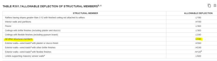

I'd say L/240 in the IRC, but what do I know....
The immediate question then becomes, is a guard or a handrail a "structural member"?
I think changed in last edition because in 2024 the highlighted line reads "All structural members excluding guards and handrails".
I kind of feel that was always the intent.
Settled in any case.
(I am worried about these being structural members and requiring a fire resistance rating. I guess this gets us back to intumescent coatings.)

Last cycle, 2024 model publication as Bill noted, there were 2 proposals for guard deflection brought up before the committee and then the membership vote.
The first one proposed a criteria based on the testing standards that are done by mass-produced manufactures. the second was a proposal to remove it all together.
The committee voted to remove it all together from the IRC, vs adding in a specific criteria. That is what is in the model 2024 IRC
Just this past April/May at the CAH1 hearings in Orlando, I believe the folks from Washington State submitted a proposal to reverse what was done last cycle.
The committee voted it down, I believe based on previous action in the 2024 cycle.
I am pretty sure they will bring it to Cleveland this fall for the CAH2... Stay tuned.
So, the exception from deflection for guards and handrails in the chart was added, but a test standard was kept out so far?

Yes & No,
The exception was added because everyone who counted, those that can vote, agreed that what was there for a catch all was not intended for guards and handrails. Manufactures and homebuilders don't get the final vote, that's on the government members...
As to test standards they are not used in that manner.
The code stipulates that guards and handrails are required to meet a design load, as thus if the math does not allow an engineer's calc's to meet the text.
