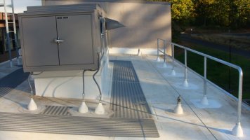

Does this mean that a fall arrest/restraint cannot take the place of guards on a flat roof since a flat roof does not have a hip and ridge?

The 2018 IBC changed the exception just because of the confusion. Plus, anchorage devices are not needed everywhere on a roof if the equipment and roof access are located in only one area of the roof.
Thanks IG,
I would like to see a picture on hip and ridge lines, that's what I'm curious about, what's that look like?
The devices shall be placed not more than
10 feet (3048 mm) on center along hip and ridge lines
and
placed not less than 10 feet (3048 mm) from the roof edge
or open side of the walking surface.
I would think they are fine on a flat roof for after the word "AND" it lists "Placed not less than 10ft from roof edge or open sided walking surface"
The intent was to allow either a guard or a restraint hookup for mechanical equipment service.
The 2018 exception was a clarification to the intent of the prior code, not a change in intent.
