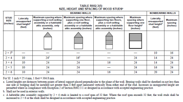

Went by to do a framing inspection on a townhome. The 20+ foot studs in the gable/exterior wall are made of 2x4’s. My buddy that normally does commercial inspections with me says it’s fine bc it’s a habitable attic and not a load bearing wall. I disagree. It is definitely considered a story. It has a stairwell, hallway, bathroom and bedroom upstairs. Different ceiling, not enclosed by the roof. And ch. 6 is very explicit on how high a 2x4 can go spaced 16 oc.

However, whether or not it's a habitable attic has nothing to do with the allowable stud height:
The picture I posted is what I consider the second floor, my co worker is telling me that it is a habitable attic and the 2x4’s are fine being over 12 ft bc it’s not a load bearing wall. I do not think it’s fine and am seeking more guidance

I would need to see a building section drawing to determine whether that's a second story or an attic. Ultimately, it doesn't matter -- section R602.3 doesn't care.
That is what I was thinking.....It is more about unbraced stud height than story/ not a story....And BTW...It looks like those rafter ties are elevated, so I am guessing that cannot be a "floor" so it is not going to be a habitable attic....And arguably not even proper roof framing....
