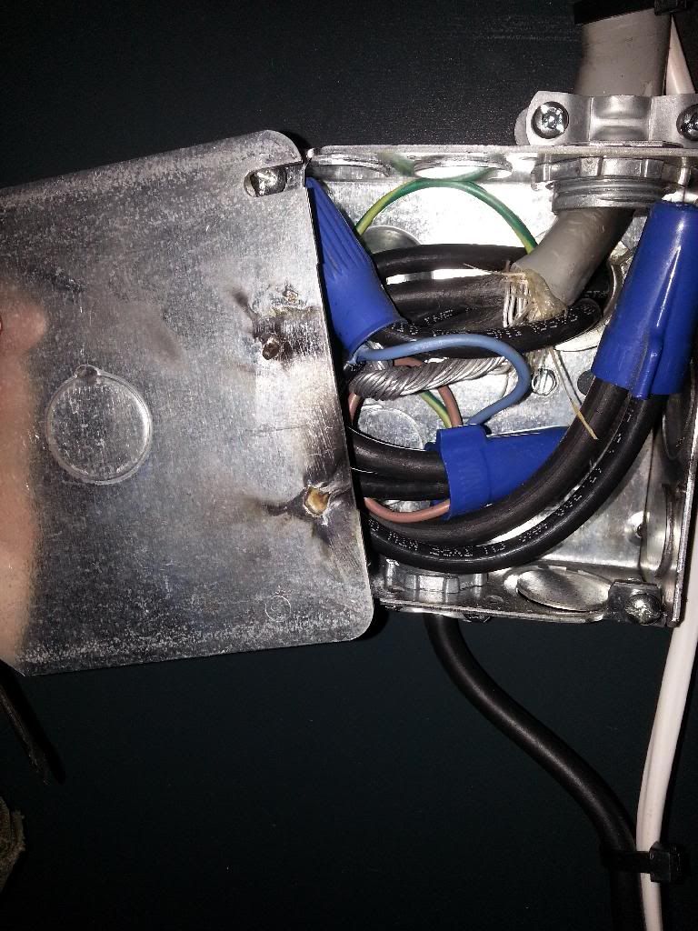

The job is a residential service upgrade done by a solar contractor. The dead-front won't come off because the handle tie hardware is over the dead-front. There was nobody there to explain why every breaker in this panel is tied to another breaker. None of the tie hardware looks to be worth a crap so I wonder if it is listed.

There are 200 amp main breakers at the top that didn't get in the picture.
The label system is different.
Equipment can be "Identified" by virtue of a listing or the judgement of an AHJ. To be identified, the equipment has been deemed suitable for the purpose. I wouldn't consider these identified. If there is a listing, the application must be for something else where the dead-front can be removed.
