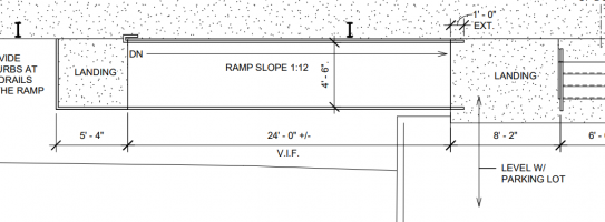

Question on ramp handrail extensions. I have a straight run ramp, at the top of the ramp is a level surface "landing" 5'4" deep and same width as the ramp. The level surface connects with a walkway on the right hand side. The inside right handrail turns and completes an extension to the walkway. The left side handrail runs around the landing up to where it connects to the walkway, but does not extend into the walkway. There is no door at the top of the landing and guardrails are not required, top of landing and walkway are 2'-0" above start of ramp (which has handrail extensions)
Does there need to be an extension where it meets the walkway? Technically there is an extension past the ramp on the left side as it continues around and the ramp has ended. If someone is using the handrail there is no change in elevation where the handrail ends (at the walkway entrance).
This is in Texas, 2012 Texas Accessibility Standards

Your drawing looks flawed
If the landing, next to the stair is lower than the corridor as it appears, then you'll fall off the corridor floor without something to block the diff in elevation
In California you would need the extension beyond the end of the ramp. If it was an alteration to existing then you could do the return, exception 3.
I will look at TX language.
I do not see any language in TX that would allow the return. It indicates "extend horizontally above the landing for 12" minimum."
So the effective running distance of his top ramp is reduced from 5’-4” to 4’-4”.
505.2 requires a handrail on both sides. 505.10 requires the extensions to be in the same direction as the ramp. That means the handrail that wraps around is not a compliant extension.

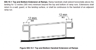

As noted within 2010 ADA, ICC/ANSI A117.1 and the IBC model building code the handrail extensions are required to be in the same direction of the ramp run.
Hence since that is the top of the ramp the handrail extension would be required to extend and close down the opening entrance from the upper walking surface to the upper landing and not turn 180 degrees to the right as currently drawn.

IBC 2021:
1014.6 Handrail extensions. Handrails shall return to a wall,
guard or the walking surface or shall be continuous to the
handrail of an adjacent flight of stairs or ramp run
. Where
handrails are not continuous between flights, the handrails
shall extend horizontally not less than 12 inches (305 mm)
beyond the top riser and continue to slope for the depth of one
tread beyond the bottom riser
. At ramps where handrails are
not continuous between runs, the handrails shall extend horizontally
above the landing 12 inches (305 mm) minimum
beyond the top and bottom of ramp runs.
The extensions of
handrails shall be in the same direction of the flights of stairs
at stairways and the ramp runs at ramps.
A117.1:
505.10 Handrail extensions. Handrails shall extend beyond
and in the same direction of stair flights and ramp runs in
accordance with Section 505.10.
Exceptions:
1. Continuous handrails at the inside turn of stairs and
ramps.
ADAAG:
505.10 Handrail Extensions. Handrail gripping surfaces shall extend beyond and in the same direction
of stair flights and ramp runs in accordance with 505.10.
EXCEPTIONS: 1. Extensions shall not be required for continuous handrails at the inside turn of
switchback or dogleg stairs and ramps.

From the IBC 2021 Commentary:
The length that a handrail extends beyond the top
and bottom of a stairway, ramp or intermediate landing
where handrails are not continuous to another stair
flight or ramp run is an important factor for the safety of
the users. An occupant must be able to securely grasp
a handrail beyond the last riser of a stairway or the last
sloped segment of a ramp. Handrail terminations that
bend around a corner do not provide this stability;
therefore, the handrail must extend in the direction of
the stair flight or ramp run. The handrail extensions are
not required where a user could keep his or her hand
on the handrail, such as the continuous handrail at the
landing of a switchback stairway or ramp (see Section
1014.2, Exception 1).

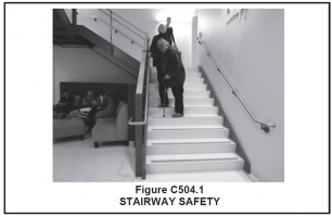

Interesting topic... I allow for alternative methods and have permitted the handrail extension turns to reduce hazards.
The extension at end of stairs and ramps can be an obstruction and hazard. Per IBC 104.1, the "Building Official may take any action including but not limited to waiving a requirement, modifying a requirement or accepting an alternate method to the requirements..."
The attached picture shows an alternative the the handrail extension that is in the ICC A117.1 Commentary. (Page 5-13)
A 90 degree turn might meet the intent of the code because the path of travel turns, but not a 180 degree turn.
However, in a lot of areas doing anything but a straight extension will invite attention from lawyers.

I.G.
Based on the photo, it looks like the wall mounted handrail, left side descending, travels the minimum required distance, then levels off and then returns to the wall. Thus, compliant unless the level off happens before the required extension is reached.
The right side descending, looks like it also extends the required distance, then runs level, before doing the full 180 degree wrap around the corner.
Thus, also compliant.
In order to delineate the end, returning to the floor in leu of wrapping around the corner helps delineate the stop and starting point of the stair flight.
More sometimes is not better, its just more.
