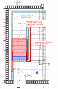

On the attached you'll see a couple of handrail options at the top landing of an exterior stair. Option A is what I'm proposing with a continuous interior handrail and an exterior rail that terminates with the required 1' extension.
Option B is what the plan checker is telling me CBC (California) 1014.6 requires, where it says …extension shall be in the same direction of the flight of stairs...
My argument is that the handrail is continuous and therefore no extensions are required. He's telling me because it is at the top of the stair, the extension needs to continue straight (red segment on attached), no exception for the handrail being continuous.
Who would you agree with?
Thanks for your input!
Neal

Steveray - the CBC language is ...or shall be continuous to the handrail of an adjacent flight of stairs... So I guess the argument would be that since there is no additional flight of stairs after the top landing, you can't use the exception. But it just makes no sense, how is the condition actually any different at the mid-landing vs. the top landing? If you're coming up the stairs using that interior railing and you get to the mid-landing you keep holding on as you make the right turn, then make another right turn up the last flight. If you're approaching the top landing you make the same right turn but then you're done, no more stairs to go up. Requiring the extension at the top just seems like adding something to snag your sweater on without improving safety or usability.
Though the argument can be made that it is similar to a mid-landing, it is not, as you are continuing to wrap and turn to the next flight, not bank left after getting there and is the exact reason why the advocates for the same direction want it that way.
And though if the handrail wrapped to another ramp or flight 30 feet away it would comply, and I have no answer for how any difference is there. None, but it is what it is.
When I tech stair flight design for compliance, I always try to get the designers to buy in to making the last tread level with each landing, in other words, add 22" to each flight by having 1 tread depth at the top and bottom before the landing requirements are drawn.
I realize losing all that square footage can be costly, but it makes for much better flow in use of the stair flights and handrails, and it is the main egress when it is needed.
But "B" is correct, not "A", though a lot of inspectors never flag it....

The code section at the top and bottom of the stair is not 1014.6 it is 11B-505.10 Handrail Extensions
Handrail gripping surfaces shall extend beyond and in the same direction of stair flights and ramp runs in accordance with Section 11B-505.10
11B-505.10.2 Top Extension at Stairs
At the top of a stair flight, handrails shall extend horizontally above the landing for 12 inches minimum beginning directly above the first riser nosing. Extensions shall return to a wall, guard, or the landing surface, or shall be continuous to the handrail of an adjacent stair flight.

1014.6 gives me the option of providing a handrail that is continuous to the handrail of an adjacent flight of stairs. if I do this, no extensions are required. But at the top landing there is no "adjacent flight" so the continuous option doesn't work and I must provide the extensions. 11B-505.10 is similar but exception #1 (that eliminates the need for extensions) says shall not be required for continuous handrails at the inside turn of switchback or dogleg stairs. No mention of "adjacent flight" until I get to 11B-505.10.2 but if exception #1 applies then I never get to 11B-505.10.2 and it doesn't apply.
I realize I'm grasping at straws here trying to find the language that allows me to do Option A (see uploaded PDF) and I haven't persuaded the B.O. thus far with my arguments. BUT I still believe this should be allowed. I just can't see how Option A is less safe than Option B. I would argue Option B is less safe since that extension could easily snag a jacket and trip someone up.
I am giving up and moving on. The unfortunate solution here is that I'm going to make the stair 3' wide instead of 4' wide (residential, occ load < 50). I don't want to re-design the spaces around the stair to allow the stair run to be longer (the other solution). If the stair is narrower the landing can be narrower and I can fit in another riser. Just doesn't seem like a good outcome. Another idea is Option C (attached) which puts a riser mid-landing which would eliminate the top riser. Any reason I couldn't do that? Again, it seems like a poor outcome.

A or C would work.. B is defiantly a code violation. The location of the door clearly places the handrail extension in option B more than 4" into the circulation path
1003.3.3 Horizontal projections.
Objects with leading edges more than 27 inches (685 mm) and not more than 80 inches (2030 mm) above the finished floor shall not project horizontally more than 4 inches (102 mm) into the circulation path.
Exception: Handrails are permitted to protrude 41/2 inches (114 mm) from the wall or guard.
Option "D" would be to furr the wall out to make the handrail extension compliant. This could be a full height wall or a partial height wall
MT,
How is "B" a violation? If the extension returns downward towards the floor to less than 27" and then returns to the guard, in a "P" type termination, the 4.5" projection limit does not apply. The same goes if it just returns to the floor period.
"A" per the letter of the code, is non-compliant as it turns prior to the minimum 12" handrail extension, and the only time it is allowed, per doe, is when it is continuous to the next stair flight or ramp run, fore which it is not, it terminates on the upper level.
"C" is compliant, because by adding the riser to the middle of the mid-landing, they can remove the top riser and make the last tread even with the upper landing, which would allow for the handrail to terminate prior to extending more than 4.5" past the guard's corner post, presumably.
But without a redesign to the stair flight and mid-landing for Option "C", I would have to disagree with "A" being compliant, it's overlooked by inspectors a lot, but it is not compliant. "B" with the proper termination to comply with the protruding objects section of the code, hence being under 27" under the projection to the floor, is the compliant option, when comparing "A" & "B".
The Building Official is given the authority to accept alternate methods and design that meet the intent and purpose of the specific code requirement. (See IBC 104.11). In a few instances, I have allowed the handrail to turn and continue the minimum required distance and then terminate to the wall or other safety return.

This is where the AHJ needs to make the call. The location of the door creates a circulation path that is not in compliance with option "B" Even if you extend the handrail to the floor you may meet the letter of the code but is it the best design? I myself and I have seen others bump into extensions as shown in option "B" and stumble or are thrown of balance. At the top of the stairs I believe that design is just a matter of time before someone in a hurry bumps into the extension and takes a tumble down the stairs.
Neal, while I believe both are equally safe in real life, a strict reading of the code says only "B" is acceptable.
If you can't get approval via alternate means and methods (see InspectorGift's post #15), and you don't have the physical room to make the stairwell big enough but you have some headroom and some money to throw at the problem, you could create a short "adjacent flight of stairs" that dead-ends onto a landing (see below).
I know it looks ridiculous, but it technically satisfies 1014.6 - - and maybe the ridiculousness actually helps prove InspectorGift's point that it is functionally equivalent in safety to just allow option B instead as an alternate means and methods of compliance.
One last thought: be careful about having even the continuous handrail protrude into the 60" door landing clearance on any of the landings. I don't think 11B-404.2.4.1 allow any encroachments into the level and clear area.
Another solution my be to use narrower studs at the door+18" to recess it back an extra 3" to get you the clearance you need.
