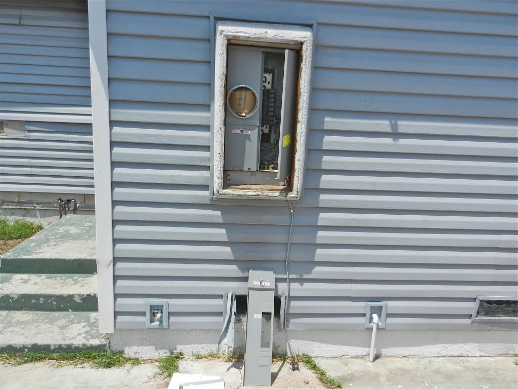

He has a license.
13,876
That's as far as the door will open.
This kind of work, the door shouldn't open at all.
Wire nut shortage!! Save some $$ on copper with the NM romex grounding did'nt they?
Are there any appliances with a greater than 30 amps in this house?
Should'nt the panel door meet the 90 degree rule as well?
I don't see any wire nuts in the panel.
Note that the bottom breaker is at least 100 amps probably a feed to the existing panel.
Door needs to open 90 degrees--adjust the trim.
Frank said:
I don't see any wire nuts in the panel.Note that the bottom breaker is at least 100 amps probably a feed to the existing panel.
Frank you have some good eyes or a better bigger monitor. You are right- no wire nuts in picture. The yellow is the excessive skin of the NMC. Am a little worried about the open ungrounded conductor that isn't connected to anything....
