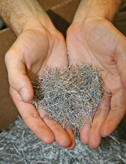

Is Helix steel fiber allowed by code as a replacement for rebar in foundations or is this product only allowed in nonstructural slabs?
Are these types of products specifically mentioned in the IBC?
FWIW, ...here is picture of the Helix steel.
According to the ESR, it sounds like it is only allowed in nonstructural slabs or plain concrete footings with no reinforcement required.

Correct, Not a Rebar replacement
Know this is super old, but just doing some googling on what's currently out there: Helix definitely can be used as a rebar replacement, based on equivalent capacity of flexural strength to the specified reinforcement. This is verified on the UES Report (https://www.uniform-es.org/media/27494/er_0279.pdf) on the second page sections 4.3 and 4.4, and on the ICC Report (https://icc-es.org/report-listing/esr-3949/) in section 2.0
This does not mean Helix can always replace ALL rebar or even ANY rebar depending on the application, but there are many structural applications where a direct rebar replacement is allowed. Wont get into any salesy talk here, just trying to provide accurate information.

Sticking to the facts, and the topic of the original question, yes the ICC has certified that Helix Steel meets the code requirements set down by both IBC and ACI to directly replace traditional rebar in foundations. The test data, calculation process, and design methods are published and publicly made available. Neither the IBC or the ACI will ever specifically mention a proprietary product - this is the purpose of the independent evaluation reports.
Its main use appears to be for temperature & shrinkage reinforcement. It requires a PE design for other applications and for footings other than seismic categories A, B & C.
Yes, PE designs are absolutely necessary - Helix replaces rebar, not engineering. The process for almost all projects is that structural drawings with rebar specs will be submit, and the Helix team will provide equivalent dosages or a hybrid rebar/Helix design. The EOR reviews the calc package, and approves (or rejects) Helix as an alternate.

As its steel, a laser screed, vibrating screed, or just decent bull float gets all the Helix under the surface. And because the product is discontinuous, any potential rusting at joint cuts won't travel throughout the slab (although the product is zinc plated). Happy to talk more directly.
