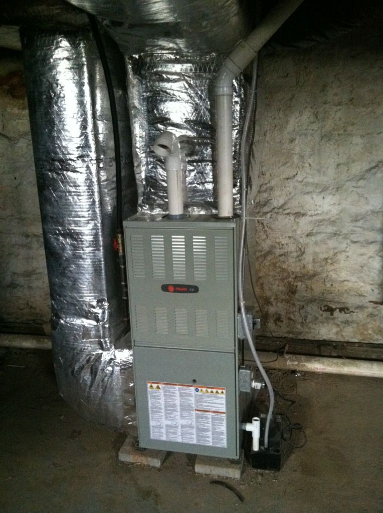

From what I understand, the manufacturer's do not consider this a HE furnace anymore.
jar,
Is this installation the way the manufacturer requires it? Shouldn't both pvc pipes extend
to the exterior?
Also look at NEC 422-12 Central heating equipment under exception #1 if the receptacle is part of the individual branch circuit does not require it to be GFI

While I know nothing of electrical requirements, being a "direct vent appliance", combustion air shall be provided per the manufacturer's instructions (IRC G2407.1). In this case, the unit appears to be a Trane XB90. Installation instructions do allow for indoor combustion are to be used as long as the criteria is met. One of those criteria being 50 cubic ft per 1000 btu.
You will find that quite a few of these high efficiency appliances allow for the use of indoor combustion air. It is still a high efficiency appliance, but the potential need for make up air to come from the outside may offset the high efficiency of the unit. In some cases, manufacturer's will send you back to the "local codes" if indoor combustion air is used. This really screws things up because it is a direct vent appliance and the code says to follow the manufacturer's instructions.
The high efficiency furnaces I'm familiar with require both pipes to terminate outside and within a foot or two of each other. This is so wind gusts don't create unequal pressures that might trip a safety switch and shut the furnace down.
You can take combustion air from indoors if the room is large enough. This makes it a "non direct vent" appliance and changes the vent pipe clearances. Look for the non direct vent charts in the installation instructions.
Love me some Johnnie Cash too. "Life ain't easy for a boy named Sue."
I can only echo what Daddy-O- posted. This is a catagory IV appliance regardless of where the combustion air comes from. The fuel gas code is quite clear that it is to be installed per manufacturer's installation instructions. In this case (for this individual appliance), so long as you don't encounter one of the requirements mandating outdoor combustion air, indoor air is okay. It still allows for low temp venting through PVC or ABS. The only difference I see between the indoor vs. outdoor is the maximum vent length. Any time you encounter a catagory IV appliance, be sure to open the manual that should be attached to the appliance. This is where you will find all of the information you need.
regardless of the code(s) requiremnts, it seem to me that taking combustion air from the inside of the house and exausing it to the outside is a waste of energy, could cause back drafting of other apliances or problems with the combustion appliance if another exauste fan pulls the air out ot the space such as a jenaire grill or some of the monstorh ove the cook top fans I have seen.
Commish I agree with your sentiments and MikeC's
A leaky or drafty house may use more fuel to heat the home but it will not make the furnace less efficient; it still consumes less fuel per BTU’s.
The appliance efficiency doesn’t change because of where the combustion air originates. The real value in efficiency is based on annual energy consumption. In a perfect Energy Star home would be constructed air tight; all gas fired appliances would be direct vented and a high efficiency mechanical ventilation (ERV OR HRV) exchanges and provides fresh make up air.
