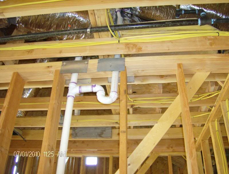

In Oklahoma they call this a high maintenence p-trap; because the homeowner has to make sure the trap doesn't go dry;
HVAC in attic; condensate disposal. At the top of the picture you will see the HVAC drain pan line inserted into the trap drain line;

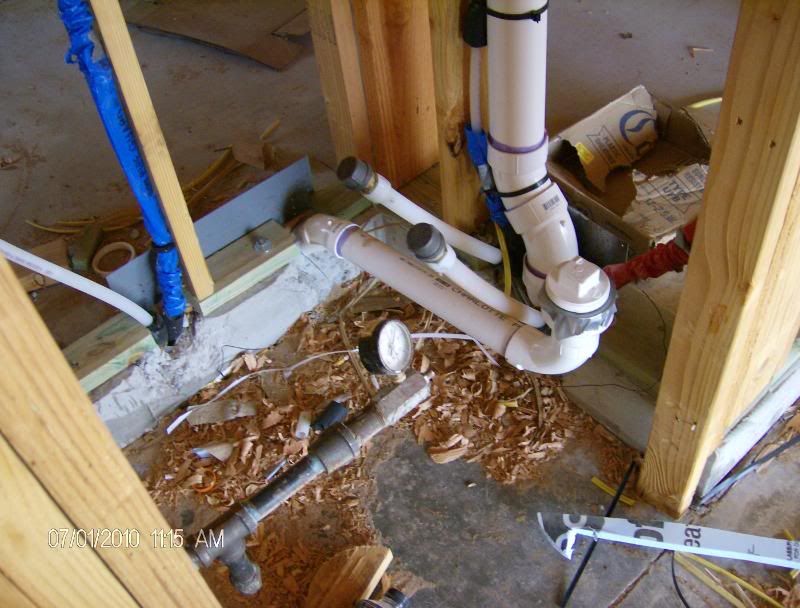

Here is another. You cannot see the P-trap because it is under the slab. The drain line with the cleanout plug is used for the water heater T&P discharge line. Again, the trap must be kept full by the homeowner, to prevent sewer gases from entering the building;
(right click on the picture to enlarge)
By the way; there is no vent on this drain. The other drain line in the picture is not connected to the one with the cleanout.

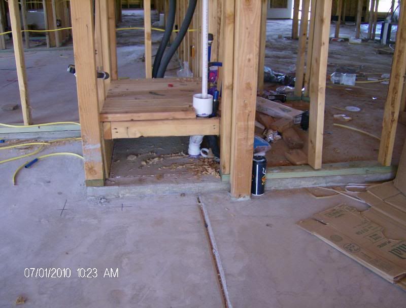

In this picture you will see the drain line from the attic HVAC unit to the high maintenence trap drain line. The water heater T&P discharge will be added when the water heater is installed. Again, no vent for trap; and the p-trap drain line can be as far as twenty (20) feet to the main drain under the slab.

UB--Isn't the fact that it is tied into the sewer the problem even before you address the dry trap issue? I thought it was against code to tie condensate drain into the sewer (though I also have seen it done). Another point is the metal plates. From the puckers I see where it is nailed, I would guess it is not the required .0625 thickness that is required for protection plates.

814.1 (2007 CPC based on the 2006 UPC) Condensate Disposal ."......shall be collected and discharged to an approved plumbing fixture or disposal area....."

I've been thinking about this and reread it and I don't think dumping the condensate disposal into a drain line is the same as discharginging it into a plumbing fixture. If it were discharged into a plumbing fixture, the fixture use would be keeping the trap full, but I'm not sure how to accomplish this. Could you tie into a trap arm? That wouldn't be a fixture though, it would still be downstream of the fixture.

First picture shows a trap that during winter would most likly dry out and allow "Mr. Stinky" into the attic area.
