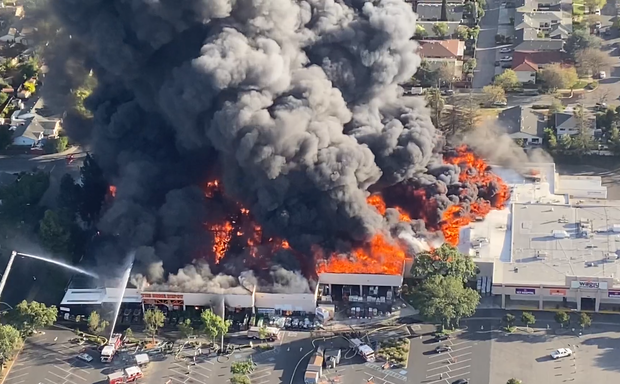

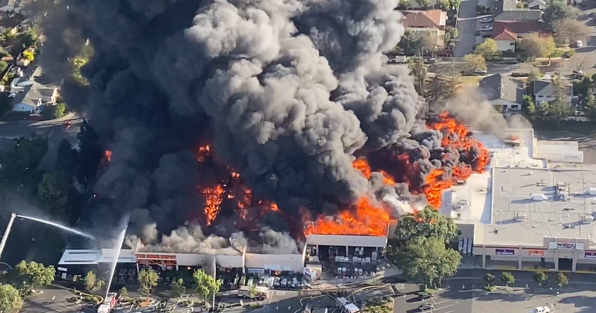

On April 9, 2022, a man trying to steal tools set a fire in the store. The fire quickly spread, destroying the 98,827 square foot store, causing an estimated $17 million in inventory loss.
Firefighters battle a 5-alarm fire at a Home Depot in San Jose, California.SANTA CLARA COUNTY SHERIFF
Prosecutors said no water came from the sprinkler system. Meanwhile, firefighters who responded to the blaze were blocked from the fire lane and fire department connections by high piles of pallets.
According to investigators, the store's automatic fire suppression water sprinkler system had been disabled at the time of the fire. Home Depot was told the system was not working, but did not fix it.
