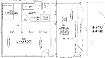

To further explain, the bedroom would not have direct access to the dwelling unit without going outside and around the garage. The garage is a different occupancy classification than the residence and obviously has a fire wall. This would mean the bedroom would be outside the residential occupancy envelope.
