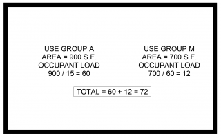

Am I able to do this if my certificate of occupancy says that my occupancy group is M?
No. This is how you calculate the occupant load for a space housing non-separated mixed uses.
Your space is not, properly speaking, all occupancy classification M. The part where the art materials are being sold is M. The part where the people are using the materials is something else.
Consider, for example, a typical Barnes & Noble bookstore. Most of them have a cafe in one corner. The bookstore portion is an M occupancy. The cafe is an A occupancy. The cafes have tables and chairs, so the occupant load factor is 1 person per 15 s.f.

Occupancy classification is based on the use of the space, not the ownership of the business.
That said, if it's the assembly portion of your space that occuopies the 700 s.f. portion, you may fit under the following:

So if the painting section is under 750 square feet, it can be classified as part of the M occupancy. In that case, there would not be any change in the classification. However, the occupant load would still be calculated as I described above.

Your shop is and will remain Mercantile unless you change the whole use (i.e. you put a commercial kitchen, or you change to a vehicle oil change business). The only thing that will change is the occupant load, the egress requirements and the plumbing fixture count. Before you get your new certificate of occupancy you will have to bump up the shop's capacity given you created this paint area (assembly space).
