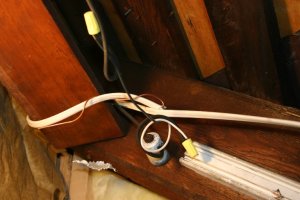

How to Connect NM Cable (Romex) to Knob and Tube
Commish, It appears the grounding wire is bent out of the way.
I think I prefer the connection in a junction box, realizing there is additional cost.
Is that #14ga ROMEX on a 15am fuse?

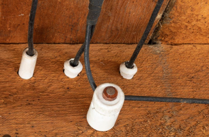

What gauge wire is the Knob-n-Tube, #12ga copper? Is it always assumed KNT is 12ga CU or does the inspector puts a wire gage on it?
I see that it is bent out of the way, to complete the hack the ground has to be cut off so the when the N & T is upgraded to a current y allowed conductors they have to replace the existing romex
I do not see anything that allows that connector without a box/enclosure
334.40 Boxes and Fittings.
(A) Boxes of Insulating Material.
Nonmetallic outlet boxes shall be permitted as provided by 314.3.
(B) Devices of Insulating Material.
Self-contained switches, self-contained receptacles, and nonmetallic-sheathed cable interconnector devices of insulating material that are listed shall be permitted to be used without boxes in exposed cable wiring and for repair wiring in existing buildings where the cable is concealed. Openings in such devices shall form a close fit around the outer covering of the cable, and the device shall fully enclose the part of the cable from which any part of the covering has been removed. Where connections to conductors are by binding-screw terminals, there shall be available as many terminals as conductors.

All knob and tube wiring I saw always had an issue with the insulation falling off. Years ago, I was had a long metal pipe which touched the hot and neutral which ran on opposite sides of a basement. ZAP!
