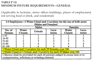

In order to post an image directly on the forum, you must be a paid member. Otherwise, you may post as a link.Nowhere is it mentioned how to count the toilets once you've gone over 100 occupants. If I have 200 occupants does that mean half is considered female and the other half male or not?![]()

If you go to the above link, go to page 604 of the pdf. There you can find Table P(1) which has the minimum number of water closets and lavatories for general occupancies such as factories, stores, office buildings, places of employment not serving food or drink, and residential. Note that this table notes that the fixtures are for the use of both sexes, and separates it into columns for men and women.
