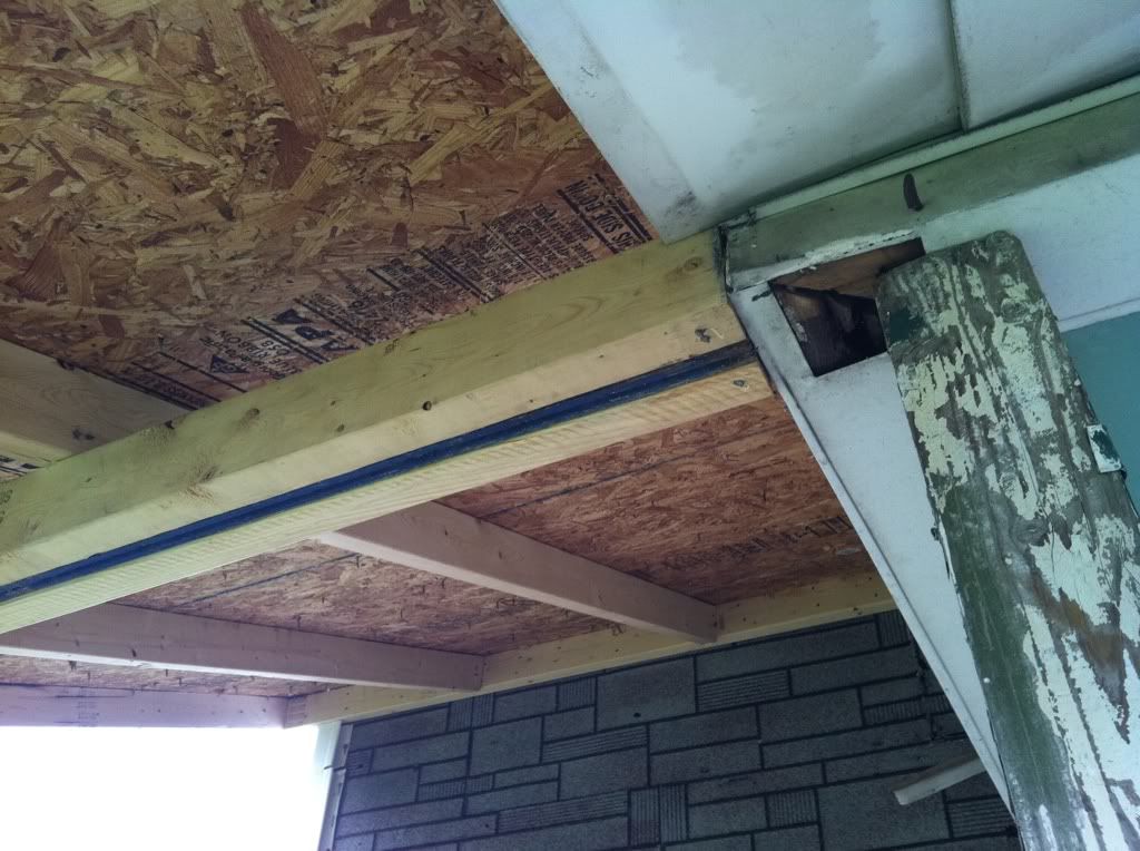

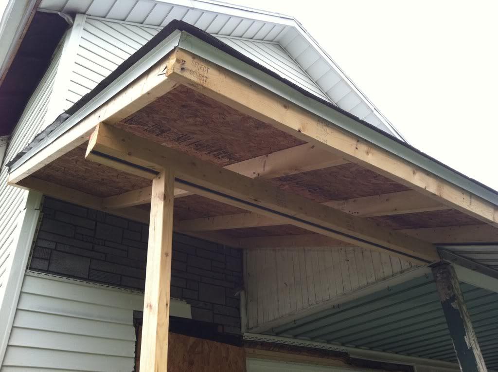

You have to be a good framer. 40psf ground snow load applies.
How many different types of siding do they have on that house, anyway? And is that a shed under the roof?
Girder looks a little overspanned (2x6's?), The ridge is not wide enough for the rafters bearing against it. Are they going to use connectors for the rafter to girder connections? Still, I don't understand the abrasive posts towards the carpenters. This job is does not appear completed, particularly as concerns posts and connections.
It looks like a work in progress to me.
I agree JS, There's more to be done.
How about the missing birds mouths cuts?
I wonder what that dark material that is sandwiched between the 2X6's?
Bill
Hard to say for sure, but in looks like the factory edge of two layers of osb . . . intending for the new beam to match the width of the existing beam.
I favor the bird's mouth cuts, but believe a Simpson tie is available for this connection without the birdsmouth being required.
