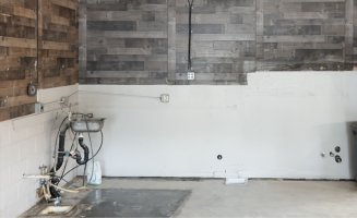

We are designing a new cafe in an existing unoccupied food service tenant space The building owner is removing and replacing the slab in the commercial kitchen room. We are planning to put sinks in the existing now empty kitchen and there are no existing below floor drain pipes on the kitchen side. It was formerly a commercial kitchen and the space is now vacant, but we don't know where any sinks were located previously - there is a hole punched through the wall above the hub drain.
We are still in the planning stages of the cafe design and don't have a contractor or plumber yet. I have made an appointment to talk with a city official, but that will be on Wednesday.
Does anyone know if draining both kitchen sinks directly to the hub is allowed here and/or what code section addresses this? I'm advising the building owner to put a floor drain on the kitchen side and rough-in a drain for the new sinks and he's resisting doing the extra work. Alberta_HubDrain.jpg

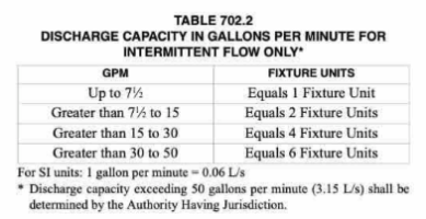

Table 702.1 generally tells you what each fixture counts as in fixture units, i.e. "sink, commercial with food waste counts as 3 fixture units. Table 703.2 tells you how many fixtures a drainpipe can handle, i.e. a 2" horizontal pipe can handle 8 fixture units. So, if your existing floor drain only has a 2" drain, it will likely be overloaded if everything you show there tries to drain through it.
Table 702.1 has footnote 1 which says, "Indirect waste receptors shall be sized based on the total drainage capacity of the fixtures that drain thereinto, in accordance with table 702.2" So check that out too.
The way it was explained to me early on was this; fill up all three sinks, put a 5-gallon bucket under the drain and pull all the stoppers at once. Based on how fast the bucket fills up, you can calculate your GPM. So instead of your 3-compartment sink only counting as 3 fixture units, it will probably count as 4-6. But that's better than counting as 9.

The hub drain in question is to the left. The only "drain" from the kitchen side is that 3/4" galvanized pipe you see above the hub drain.
I am an official, just not your official. Yes, probably a 3 inch. Or, multiple 2". Tell him to hire a contractor and get a permit, if not, you want a hold-harmless agreement. This isn't in Beaverton is it?

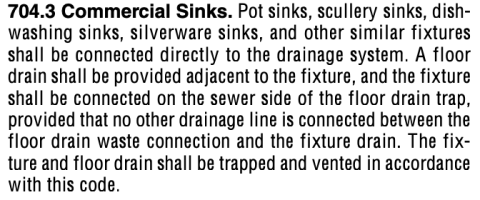

Portland. I've never had any projects in Beaverton, but when a client first contacts me and I find out they are in Portland, I sigh and know to estimate half-again as much for my design time. While I know every jurisdiction has it faults and particularly difficult staff, I've never encountered anything like Portland. Waiting three or four days for 15 minute video conference is the norm - that's the department's preferred way of interacting with the public. However, in the "old days", about one out of three calls were never returned, so I appreciate the certainty the scheduled video chats provide. You can still get just a call back, but with the same old no guarantee... My meeting on this topic was scheduled for tomorrow, but I canceled it after the owner agreed to get his plumber out there - it helped to send him to the the 704.1 tables with a little explanation and no fibing was needed in the end!

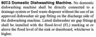

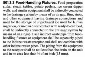

Be aware that I said that your code MIGHT look like that. Not all jurisdictions require a direct connection and might approve an indirect or even require an indirect such as an air-gap over a floor sink. What I thought would help you with the client is the news that a floor drain is required with a direct connection.
Oregon uses the Uniform Plumbing Code as a model code, as does California, so you do likely have that section that @ICE is referring to. You probably also have this section:
And, unfortunately, as @ICE is also pointing out, there's the code, then there's what local jurisdictions actually enforce. For example, there is this section that literally nobody enforces.
When I was the inspector, I enforced it, and it was a battle every time. After fighting it for years I began a widespread effort to communicate with other jurisdictions in NorCal (beyond my little redwood curtain bubble) hoping to find support, but no, I found I was alone on a hill. When I took the promotion and hired an inspector, I told/showed him the code and explained it, then said it's up to you if you want to join the masses or stand alone.
