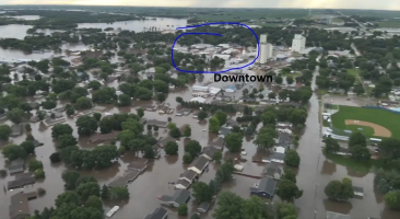

Not just hurricanes causing issues either. This happened earlier this summer after 18" of rain in one day in northwest Iowa, about 20 miles from my house. My niece lives in this town, and the same river took out my brother's auto repair business in another town about 10 miles upstream. The river is normally about 25 feet wide, and since it was a dry summer until this you could probably walk across it with waders or maybe even knee high boots in spots and stay dry. This picture is Rock Valley Iowa.
What "weakening" and "less stringent standards" made the flooding damage worse in Rock Valley? When water is several feet or more above the first floor (US first floor) what "strengthening" of the codes will help? Maybe ICC should develop their own flood maps?

Not trying to be argumentative, but many of the proposals to "weaken" the code I've read would not make a difference in destruction and loss of life from floods and high tides. Just looking for some specific changes that would have significantly reduced the bad results of Helene.

If you are in a flood zone, assuming you have adopted codes, you shouldn't have to worry about this again. Unless you have bad enforcement....If you were not in a flood zone, most codes would not have helped you as we really design structurally for wind as far as these events go. If more jurisdictions supported their code departments, maybe we could get more code people involved in writing codes that benefit our customers more than some lobbying group....
