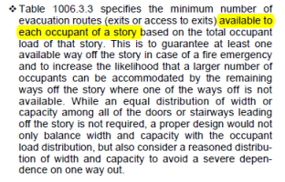

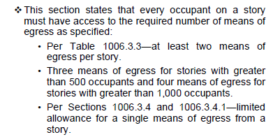

The ICC Commentary to section 1006.3.3 says:
The the Commentary for Table 1006.3.3 then says:
Based on these two ICC opinions, I think each tenant suite needs to have access to both exit stairs, subject to the allowable common path of travel.
