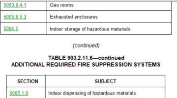

My 1st thought is what type and how much chlorination will be used and stored in this structure?
International Fire Code
903.2.11.6 Other required suppression systems.
In addition to the requirements of Section 903.2, the provisions indicated in Table 903.2.11.6 require the installation of a fire suppression system for certain buildings and areas.
TABLE 903.2.11.6
ADDITIONAL REQUIRED FIRE SUPPRESSION SYSTEMS
SECTION 5005
USE, DISPENSING AND HANDLING
5005.1 General.
Use, dispensing and handling of hazardous materials in amounts exceeding the maximum allowable quantity per control area set forth in Section 5003.1 shall be in accordance with Sections 5001, 5003 and 5005. Use, dispensing and handling of hazardous materials in amounts not exceeding the maximum allowable quantity per control area set forth in Section 5003.1 shall be in accordance with Sections 5001 and 5003.

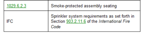

Forgot to include the code path from the IBC to the IFC section 903.2.11.6
[F] 903.2.11.6 Other required suppression systems.
[F] TABLE 903.2.11.6
ADDITIONAL REQUIRED SUPPRESSION SYSTEMS.....
TABLE 903.2.11.6
SECTION 5005
5005.1 General.
Lol, he's going to get into a hazardous assembly type and be in for a real treat. :)
Not if you keep the quantities below the hazard limits. It is educating the pool operators to not stock the building with amounts greater than what's allowed that is the issue after the pool is operational.
