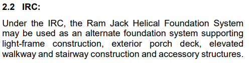

My doughter has some cracks in the walls & ceilings of her slab on grade house in south texas, and she is getting proposals from foundation repair companies. One particularly high pressure sales guy was saying their system has building code approval, and everybody else uses cheap inferior methods. Here‘s a shot of part of the brochure. Sure enough it claims to be certified by ICC-ES, but the details are vague. I tried to research it, wasn't easy. It’s the same ICC that publishes the code book, but it looks like the “certification” only says the method meets the definition of the code.
I’m not sure I like the idea of the ICC publishing this type of information. It’s not a UL rating, just an opinion that it meets the definition. I assume the ICC gets money for this. And the sales people twist it to make it seem like it's a code item.

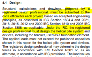

The ICC ESR acceptance only means the product is acceptable under the code for the uses specified. The ESR report does not presume to engineer the specific application, it just says an engineer can specify this product and be good under the code. I would strongly suggest that your daughter consult an independent geotechnical engineer.

4.3.1 IBC: Continuous special inspection in accordance
with 2021, 2018, 2015 and 2012 IBC Section 1705.9, 2009
IBC Section 1704.10, and 2006 IBC Section 1704.9 is
required for installation of the Ram Jack ® Helical Pile
foundation system
. Where on-site welding is required, special
inspection in accordance with 2021, 2018, 2015 and 2012
IBC Section 1705.2 and 2009 and 2006 IBC Section 1704.3
is required. The special inspector must verify the following:
1. Verification of manufacturer product model numbers
(see Table 1).
2. Types, configurations and identifications of helical pier
lead sections, pilings, extensions, brackets, bolts and
torque as specified in this report and the construction
documents.
3. Installation procedures, anticipated and actual piling
depth.
4. Required target installation torque of piles and depth
of the helical foundation system.
5. Inclination and position of helical piles; hub of pile
extension in full contact with bracket; full-surface
contact of foundation brackets with concrete; tightness
of all bolts; and evidence that the helical pile
foundation systems are installed by an approved Ram
Jack® installer.
6. Other pertinent installation data as required by the
registered design professional in responsible charge
and compliance of installation of helical pile system with
the approved geotechnical investigation report,
construction documents and this evaluation report.
4.3.2 IRC: Continuous special inspection of helical pile
system and devices installed under the provisions of the IRC
defined in this report is not required.
5.13 Settlement of the helical foundation system is outside
the scope of this evaluation report and must be
determined by a registered design professional as
required in 2021, 2018, 2015, 2012 and 2009 IBC
Section 1810.2.3 and 2006 IBC 1808.2.12.
