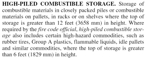

So what is the maximum height, indoor, for idle wood pallets?? Maximum stacks? Separation required?

HIGH-PILED COMBUSTIBLE STORAGE. Storage of combustible materials in closely packed piles or combustible materials on pallets, in racks or on shelves where the top of storage is greater than 12 feet (3658 mm) in height. Where required by the fire code official, high-piled combustible storage also includes certain high-hazard commodities, such as rubber tires, Group A plastics, flammable liquids, idle pallets and similar commodities, where the top of storage is greater than 6 feet (1829 mm) in height
And don't let the presence of sprinklers fool you. A lot of light industrial, manufacturing, mercantile, etc. is designed for Ordinary Hazard Group 2. Even with that level of sprinkler protection, you're limited to 6' height, and no more than 4 stacks per pile, with at least 8' of space between piles. If you put too many together into a single pile, even if it's under 6' high, you double the sprinkler demand. NFPA 13 section 12.12.1.2 if you want more detail.
The hazard is due to the materials surface to mass ratio. Defined as a High Piled Combustible at >6’ stack Extremely high hazard as classified and defined in IFC world (3206.6) Separations required in (3206.3.2) and sprinklers when area is >500 s.f. (T3606.2).
