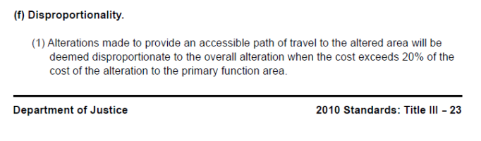

The 20% rule came directly from the ADA. The original ADA said the cost of providing accessibility upgrades in existing buildings should not be "unreasonable" (or maybe the word was "disproportionate" -- I didn't look it up). But the original ADAAG didn't define what unreasonable/disproportionate meant, and over the year various courts settled on 20% of the total construction cost as being a "reasonable" cost for required accessibility improvements.
It's spelled out in the 2010 ADAS:
That still doesn't necessarily protect someone from liability. It helps for sure, but it's not a guarantee. There's still REBR (readily achievable barrier removal) requirements that, regardless of the 20% rule, could still create a headache.
Outside of REBR elements, yeah, the 20% rule will probably protect most tenants / landlords.
