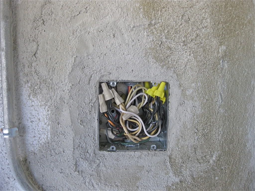

mallet to get it all in there, perhaps it's too full. This was one conductor shy of double the capacity.
Had to think about that title for a while to get peoples curiosity up on that one huh? :)
Just a tad bit tight!! That's one of those...get a 2X4 and pound the wires in until you can get a cover on it!!
Can ya'll please cite the appropriate code section ( or sections ) that this violates.
Thanks!
for Box fill see 314.16 2008 NEC
Need to also check EMT fill 40% max of cross section Table 1 chapter 9 2008 NEC

ICE, Thanks for the PIC, I agree it looks overloaded and it's for sure a violation.
How do you determine the box cu inch allowable fill? Is that type box marked where you can see it?

Suppose a jurisdiction does not use the NEC. Where in the IRC or SBCCI or ICBO
or BOCA codes would Article 314.16 be located? For our discussion, we will limit it to
the IRC code.

E3905.13.2.1 Conductor fill. Each conductor that originates
outside the box and terminates or is spliced within the box shall
be counted once, and each conductor that passes through the
box without splice or termination shall be counted once. Each
loop or coil of unbroken conductor having a length equal to or
greater than twice that required for free conductors by Section
E3406.10.3, shall be counted twice. The conductor fill, in cubic
inches, shall be computed using Table E3905.13.2.1. A conductor,
no part of which leaves the box, shall not be counted.

Did you know there is a cross reference in the back of the IRC that specifies what section of the NEC and the IRC is?
2006 IRC
E3804.6 Conduit and Tubing Fill.
E3805.13.2 Box fill calculations.
..and for when they decide they can fit a receptacle in there, E3805.4.
The cu in of the boxes are usually stamped or molded into the box.
Mule, Help me with this,
There appears to be 9 wire nut splices and if they are all 14ga wire? that would be 9-nuts x 3conductors(estimated per nut)=27 total conductors x (2.00 cu in. per 14awg conductor)= 54 cu in of box required? Does that look correct?
If the box is a 4x4x2= 32 cu in, the box is overloaded by 22 cu inches. Close?

I'm wondering what did ICE / Tiger do to obtain compliance of this obviously overloaded
junction box.

Mule, Help me with this,There appears to be 9 wire nut splices and if they are all 14ga wire? that would be 9-nuts x 3conductors(estimated per nut)=27 total conductors x (2.00 cu in. per 14awg conductor)= 54 cu in of box required? Does that look correct?
pc1
I don't know if I'm the best one to help you out...but yeas based on the table and your guesstimation of conductors I would say you are correct.
pc1
I believe that the box is a 4 11/16 X 2 1/8" box. With that being said the CU inches would be 42. Now not all the wire nuts have 3 conductors in them some have 2 so it is hard to guess the number of wires. Also as pointed out the equipment grounds only count as one conductor.
With a quick count I came up with 19 wires and 1 for all the ground wires. If these are #14 conductors that would be 20 times 2 cubic inches so the box would need a volume of 40 cubic inches. If the box is a 4 11/16 X 2 1/8 box it would be fine.
junction box..
They installed an appropriate size j-box. I wasn't the follow up inspector. What isn't obvious from the picture is that the box is recessed from the surface of the stucco 1/2", so that was corrected also. The dwelling was owned by a bank and the work was done by a licensed contractor. There were many violations and I was surprised that the work passed on the next inspection.
figuring the volume is easy (heightxwidthxdepth). Not all boxes that look overfilled are (and some that don't look overfilled, are indeed overfilled). Need to count the conductors (which usually means pulling them all out). Count the grounds as ONE (no matter how many there are) and the devices at twice.
pc1
I use the eyeball method. If it looks too full, I tell them it's too full. Sometimes they tell me that I'm full of it. I say, could be, but not as full as the box. They ask how many can they have. I tell them that I don't know but it's written down in a book somewhere and it's not as many as they have because it looks too full.
