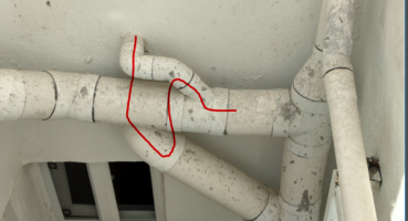

There is a mechanical shaft that all the plumbing runs into. Each of my two main floor baths have a separate shower drain into this shaft. There are not traps on the shower drains, just a device comprised of a cap that is supposed to seal off the gas. It doesn't! However, for one shower drain, it exits the wall into the shaft, turns 90° to a horizontal run of about 3'. There is room to install a running trap. On the other it exits and turns immediately downward into the common drain. I think a p-trap could be installed then turn back into the drain. These are about the best options I can come up with. The shower drains are about 24" from the shaft walls. There are vents, not good, but I think workable.

Look down the drain, notice the water held outside the pipe. about 1" deep, the cap sits over the pipe and extends into the water a little, which is supposed to "trap" the gas.
This is the cap.
