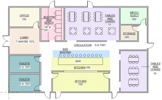

(4 years later I still struggle with this one). Referring to the diagram below (not a real plan), wouldn;t the total occupancy and toilet fixture counts be based on the occupancies of the individual colored areas and not include the square footage of the Circulation and Toilet rooms? If you add occupancy load for Toilets and Circulation, aren't in effect doing double duty since guests are either walking to the toilets or in their seats, or working in the kitchen?

In this example, since the restrooms and circulation space primarily serve a "net" load factor function, then you are correct. The OL and Plumbing Fixture Count should not include the circulation space or toilet rooms.
If this was instead an office building (with a "gross" load factor), you would include circulation and restrooms when determining the OL and fixture count.
The circulation space gets arguable...Once you omit the walking space behind the bar seats, why not the walking area between the tables and chairs? How about the room at the door swing?.... .But I am reasonable...
I get your point. In this case though, I have plenty of exit width in this case but am concerned about toilet fixtures. I don't think I should have to include the main circulation hallway area for determining toilet fixture quantities..
I'm reeeeaaaallly reasonable on toilet fixtures....Unfortunately the IBC isn't...but I think that change is being worked on...
