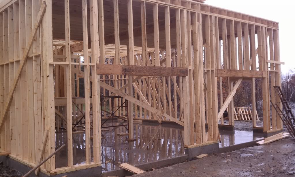

Insanity continues, attached garage not per approved plans

Now they are out of the prescriptive codes for framing and wall bracing (12' max) with this change without notice. Was there for a footer inspection in the back.

In all seriousness, probably not a huge deal. Will need some design work done, but probably easily fixed. At least it looks like they take some sort of pride in their work.. appears to be decent.

They hired an engineer who started specs on a fix then decided to refer it over to another engineer who provided specs on a method to fix. It was basically completely reframed from the inside.
