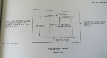

I found some pictures from a 1997 Building Code Handbook.
This last picture is kinda goofy in that nobody would do that. There should be a depiction of half a can of expansion foam. IMG_3293.JPG
Here the blown-in insulation would fall into the cavity if I understand the issue. I too would require a lid or metal panning because its suppose to be sealed at the ceiling level and floor levels, see IRC 302.11. (4)
This last picture is kinda goofy in that nobody would do that. There should be a depiction of half a can of expansion foam. View attachment 8053
That's a wall not ceiling
