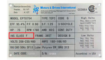

Here's an example of a typical motor nameplate:​
Good information, but i question if all those items are appropriate to be checked by the inspector. RPM for example … why does the inspector care if the speed is correct? Where would you cross check to confirm it is correct?
One question: isn't the FLA used only for the Overload protection, and the FLC rating in the NEC tables 430.248 and 430.250 used for conductors and the overcurrent ratings?
Andy.
As an inspector, I don't believe that we need to worry about speed. However, we have to consider voltage and current. With some electric motors, such as for fire pumps, we need to know the locked rotor current (LRC).
