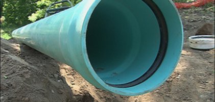

*If they use materials that are "approved for use within a building" then they're fine. In reality that usually means glued ABS or PVC instead of compression joints. Typically, we see them transition to the green PVC with compression fittings (on the street they call it "SDR") but that's not approved for use within the building.

The material we often see outside of buildings is a PVC material, but they are not glued and therefore are not permitted to be used within the building. They are green and are fit together by a compression joint, commonly called "SDR". Apparently on civil sheets "SDR" is an acronym for "Standard Dimension Radius" but the name stuck and is now what they call this pipe.
