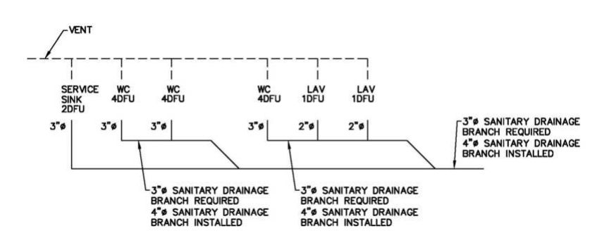

916.4 Multiple branch vents. Where multiple branch vents are connected to a common branch vent, the common branch vent shall be sized in accordance with this section based on the size of the common horizontal drainage branch that is or would be required to serve the total drainage fixture unit (dfu) load being vented.
If the common drainage branch required is 3" and I upsize it to 4", is the common vent size based on the required 3" drainage branch or the provided 4" drainage branch?
Thanks
