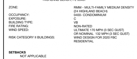

We review to the proper values...not hard on residential......On commercial we verify they used the correct values, which they usually state on the structural plans.
Is Table R301.2 required to be included within the plans (filled in with correct data) at the time of submitting plans for permit?
If what you are designing has factors that must be taken into consideration then yes, you include that information.
If you are remodeling the interior of a home, then no need to put footer frost depth requirements. If you are adding on an addition, they you would put that. If you are remodeling a kitchen with no change of windows or doors or walls then we don't care what wind zone you are in. It is common sense.
If you are building a new building, they you should list all of this information on your plans top declare your design criteria. You don't have to post the actual table, just the relevant info for design.
